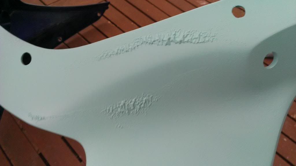

    so im attemoting to fix my plastics atm but when i sprayed the front cowling im getting this bubbling
    it happened when i sprayed on the plastic primer and also when i sprayed on the filler putty
    what step am i missing as this didnt happen on my left side fairing
    cheers ric

    Are u cleaning the parts with a wax and grease remover?

      some sort of chemical /oil residue ?

        What Topcoat and Primer did you use? looks like it might possibly be enamel over acrylic

          Enamel over acrylic tends to go more a tight crinkle pattern. This looks like some sort of oils or residue comin out of the plastics

            i used plastic primer and srpay on filler both rattle cans from repco, it starts as a tight crinkle and that might be just a shit photo.

              the paint on those plastics can be sensitive,if you put any paint on them in wet full coats it can/will react just like your pic.
              put the primer on in lighter coats and give it time to dry off in between coats.

                It appears that when you rubbed the original paint down you cut through the top coats then you applied your primer pretty wet and it got under the edges of the cut through areas! This used to be a problem with Eurocryl clear over base if you had to do a touch up on fresh clear the aggressive metallic base coat would fry the fresh clear.
                If you rub it back to start again try using dry coats of primer to start with and let it dry between each coat. If not look for a sealer perhaps, this problem can be a nightmare.
                Haven't been a pro painter for some years but your problem was very common back in the day.
                If the original parts are not painted but just coloured plastic then ignore the above.
