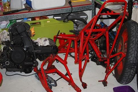

    As posted earlier, I finally found an affordable example of the Ducati 750 F1 that I had always wanted for a project bike. The bike in question is a 1986 (F1 model, which was an improved version of the original 1985 released bike. In 1986 the 750 F1 crankcases were strengthened, and now used straight cut primary gears driving a hydraulically activated dry clutch, and stronger gearbox. The valve sizes were increased to 41 mm and 35 mm, as used on the TT2, and this meant smaller 12 mm sparkplugs were fitted. Other features were 40 mm Forcella front forks, Veglia instruments, and a steel petrol tank. This bike was in pretty good condition, given that it is 25 years old and has been ridden regularly (69,000 kms on the clock). I picked up the bike on Thursday & found the ride home to be extremely enjoyable, more so than my 1198s Corse I have to admit. This bike is such fun to ride and you really can give it as much throttle as you like without worrying about being dumped off it or anything.
    So I started the strip down yesterday after getting home from work. I hadn't really intended to get onto it so quickly, but I was looking at it & thought "what the heck'. I pretty much finished the strip down this afternoon (about 6 hours in all).

    During the process of stripping the bike, quite a few things came to light. I dont think there were any 2 bolts, nuts or spacers that matched - some were allen head, some grade 5, some grade 8, some imperial and even a few stainless ones were found. Spacers had been replaced with nuts, washers were fitted in one place but not the other, etc, etc. I'm planning on replacing every nut & bolt with either titanium or stainless as she goes back together.
    The electrics were an abomination, with wires taped together, dodgy terminal connections all over & one of the spark plug leads was even spliced together! I guess one could argue that it was all an improvement over the factory wiring in its day, from what I remember. I will be calling on a good mate of mine (who is a bike nut auto sparky) to manufacture a complete new wiring harness.
    The instrument cluster has been bastardised & is beyond salvage, but I have already managed to locate a complete brand spanking new replacement for a very good price.
    The front brake rotors are non genuine as far as I can tell. From all accounts, all 750 F1's came out with 280 mm full floating Brembos, but for some reason this one has fixed rotors. This is definitely going to be a labour of love and I'm sure it wont happen overnight (given the difficulty in locating parts these days), but I have decided to rebuild her back to original, just as Mr Taglioni intended. One thing I do have in my favour is the 30 years as a mechanic, which I believe will be invaluable with this little project.
    The first step will be to get the frame, swing arm & centre stand cleaned, blasted, inspected for cracks/bends/damage and powder coated. Whilst this is happening I will be working on locating all the little bits & pieces needed to bolt them all back together.

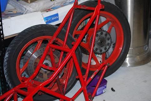

                          It's been a while; the past 12 months have been a real struggle to locate NOS parts, but I'm getting there. I picked up the frame, wheels, forks & swingarm from Niall the other week & have started the assembly.
                          Firstly I cleaned the fork parts & tapped out all the threads for assembly. These went back together with new piston seals (no longer available, so I had Transeals make me up a set), new chrome stanchions (NOS), new seal retaining caps (NOS), all new hardware (NOS), new adjuster caps (NOS) and all new o-rings. The actual fork seals were good enough to re-use, which was fortunate as these are unobtainium these days (transeals wanted $8.00 a piece to make them, but with a minimum order of 500 units!).
                          Oh, and thats a custom made titanium from axle in the pic's. I had this made through a chap in the UK who specialises on TT bikes, along with a rear axle, swinarm pivot shaft & some nice aluminium wheel spacers.
