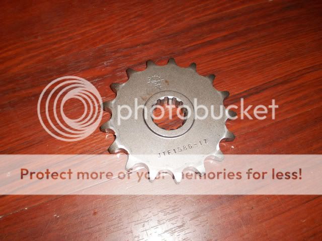

    First up the bike (pics to follow) Its a 1999 TRX 850 in Black as the previous owner stated in his add it was a mistress so it came needing service and a tidy up. The first hurdle was the rear shock not rebounding the adjuster was seized this was fixed on the spot at his house GREAT. Next up the ride home a few things stood out FUN ENGINE levers too high for me, suspension really soft, soft tyres 15 psi ^_^WAY over geared so this
    it was chucked and a 16 put on first day along with oil and filter, plugs tappit check and a lube.

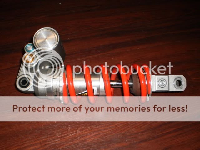

    Next up is suspension the rear what to do! With limited $$ overhaul the stock one revalve with a new spring, after market $$$$ or fit another one from another bike so in steps this
    07 R6 shock with an ohlins stack in it Thanks Black FZR

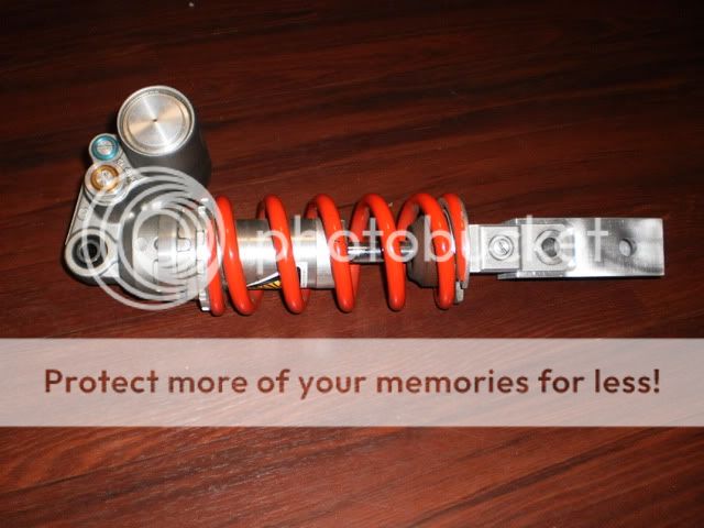

    Then I needed one of these an adapter to get it to the right length
    Quick test on the kitchen floor Going to fit it later tonight then ponder the front end. It a damper rod fork not my favourite so I'm on the hunt for another set of right way up forks, its a bit hard as they are only 41mm so will see what I can find. Not keen on USD as it will ruin the look but hey you never know. Engine MMM FCR's, Over racing cams and maybe a set of rings MMMWWWAAAAA

                    FCR's on the way WHHOOO Bolt on 7-10 hp from what I've read. Next the forks man they are a drama I just hate damper rod forks. The rear shock is pretty good so far the bike is a bit higher in the rear so steers a bit faster which I like but it does make the front feel soft and wallow. More updates to come! Did I say the TRX is just fun to ride with an extra 7 or so hp its going to be a blast.

                      whats the stroke length on the r6 shock? have you lost suspension movement from the original shock?

                          Yep a little but I can live with that as the spring and valving are closer to my needs. Its gained 10mm in ride height whhich it needed aswell.
                          MM
                            from an engineering point of view, i hope the new spring is stiffer than the old one otherwise you might end up bottoming out the suspension going over anything bigger than bees snot.
                              1kgmm enough from an engineering point of view! There is less travel loss than the picture shows. The bike rides much better.
