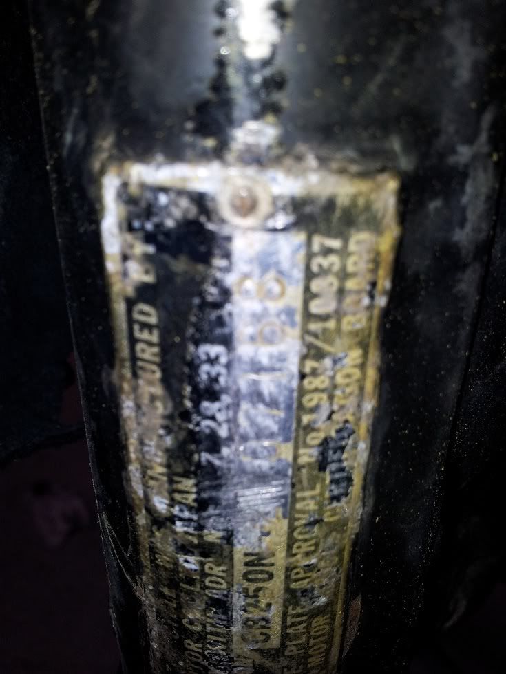

    Almost finished stripping the frame. never again will I be such a tightass, next bike is going to the blasters.
    just a quick update, called the DPI just to double check that my frame will be fine as when I moved it one of the numbers was scuffed off the VIN plate.
    They said it will be fine as they will cross reference it with the engine number
