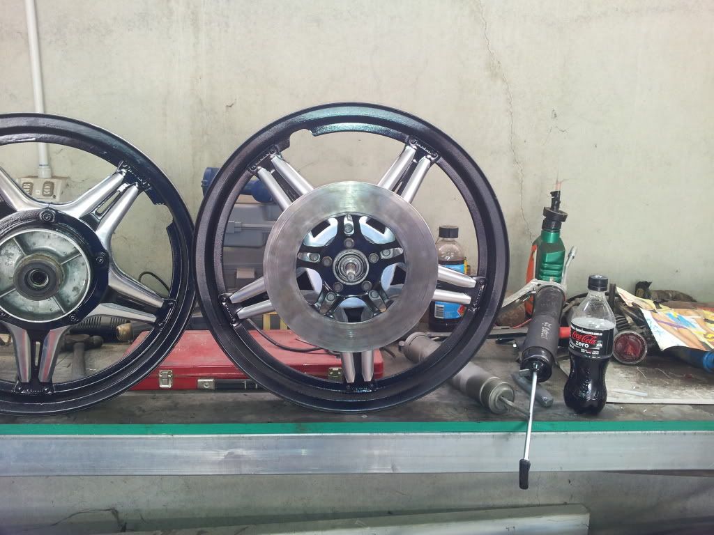

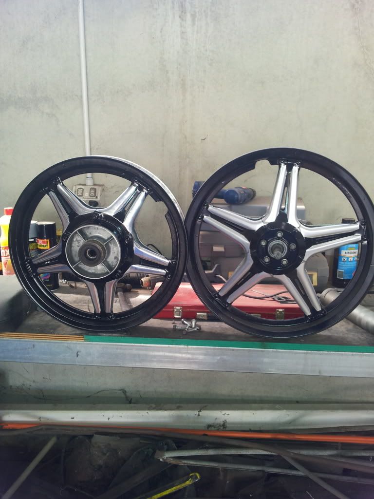

    Small update, I have been on holidays to try and finish a few things aroung my house and finally to get the keys and move in, so the bike has been on the back burner for the last 2 weeks.
    Finished painting the back wheel
    And finished the disc for the front wheel
