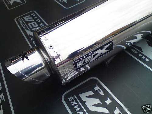

                          oh. The new stuff
                          new sprockets and chain
                          new pipe and emission blanking plates
