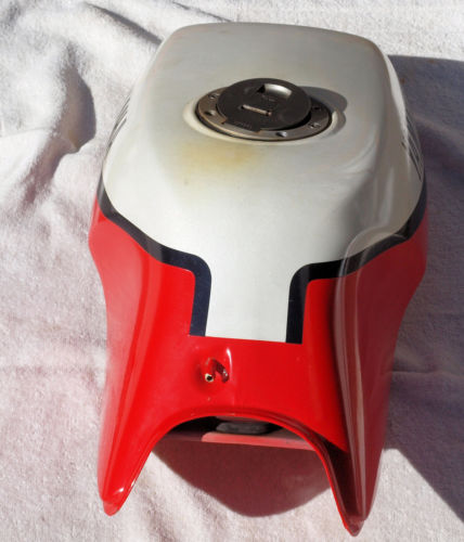

    Unfortunately while the bike runs, it came with the gas tank stripped down, and I didn't realize until after purchase the pet cock assembly was missing. I've since ordered parts through Partzilla but finding that I'm not completely sure what connects to the connector at the back of the tank that points towards the front of the seat? This isn't my tank but it shows the connector on the rear that I'm wondering about?
    Where does #51 go?
    I'm also seeing what appears to be a shut off valve after the pet cock with also maybe a fuel filter? Was this OEM?

    as for 51 well thats a good question. It could be a breather tube.
    Ill have a look on the microfiche
    Atlas Performance, dyna pumps, " your name goes here"
      Wow, those US bikes have some complicated emissions gear. Here in Australia #51 would go straight to the road, as would 43.

          item 20 is the fuel filter in the tank, so i would guess that the valve was added because the floats in the carbies was a bit hit or miss.
          Item 15 is the standard item.

            drop a bit of fuel around inside were the petrol cap is
            see if it runs out that pipe out the back of the tank ?
            it looks like if you over fill the tank thats the run off pipe
            make sure there's enough flexible pipe on the bike from that pipe and run it down under the bike
            excess petrol can run away from the bike not damaging bike components with fluid

              yeh i think the rear one is overflow drain, it'd come out somewhere left hand side near the footpeg and stand, you might be able to see where it was mounted?
              The shut off valve surely isnt OEM and is way too small for a filter, so its only an on-off valve,the only reasons i could think of is because the fuel cocks stuck open and they didnt want to take it apart or buy a new one because it cost too much too hard...., or it was going to be some kind of easily accessible take the tank off tank fuel line quick release ??
